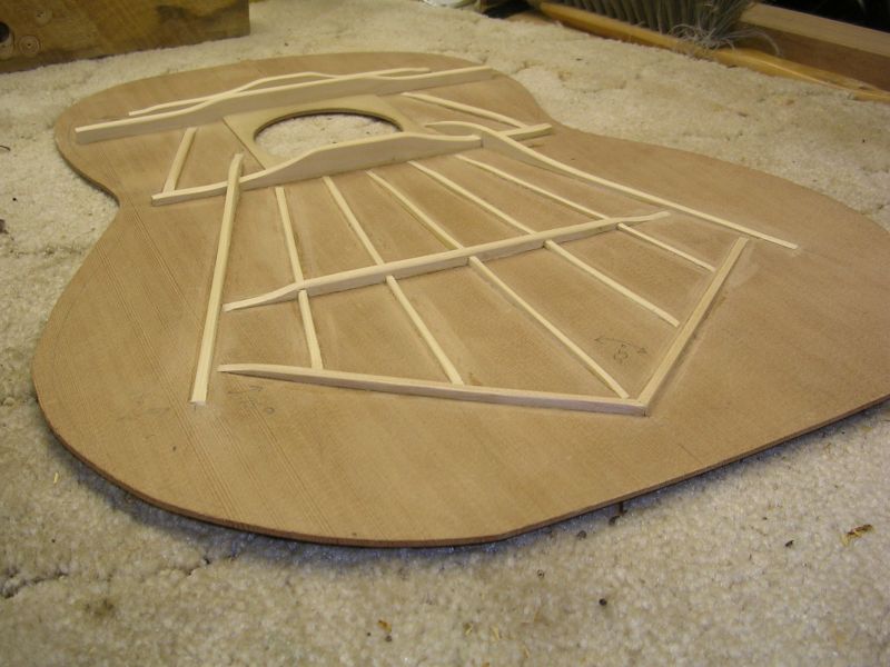

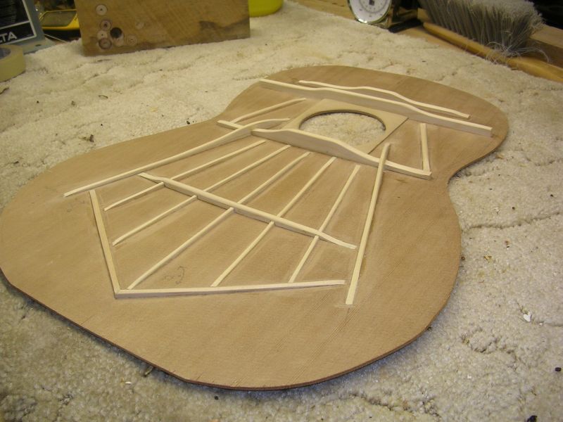

Yeah I know, I know. I still need to spend some time cleaning this up and I need to make some minor adjustments to the upper cross brace but I thought I'd give a peek at what I'm working on right now
Just don't mind the mess...
You can see here that I can't do anything "by the book".
Thanks for looking.

Nice looking Ronn...
Is that a fan braced SS? Looks a little big for a classical but it just might be the picture. Good work either way
Joe Beaver

Just the pics... It's a classical. The center fans are 3.5mm x 3.5mm and the center brace across the fans is 7mm x 7mm. Maybe that will help put into perspective.

OOOOOEEEEEE!! Nice piece of work, Ronn,
What mess?
Is the lower cross brace, above the V, notched to fit the fan braces?
I'm amazed at how much more intricate the tops of classicals are compared to SSs.
Keep us posted please!

Excellent work, I like that bracing pattern. What is the rest of the guitar plan?

Pat That brace is notched to receive the fan braces just as the outer fans are notched to receive the lower transverse brace (below the sound hole).
Mike the rest of the guitar? Its a indian rosewood cedar topped classical w/ rosewood binding and maple purfling.
Serge Boy you ask some tough questions. I can't answer. Sorry maybe someone else will be able to. There is a theory that says the braces direct the sound/vibrations out across the soundboard so..?
All of this is really experimental for me right now. I've been going through this book ("Building Master Guitars")and building several of the different styles there. All this just to experience the difference in sounds. I plan to settle down with one or two bracing patterns and try to refine the sound to my taste.

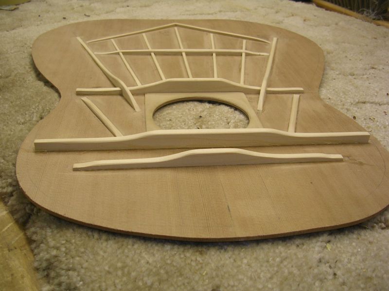

Do you plan on cleaning up the back? If so, how?
I always wonder what other luthiers do with the backs of their tops. This is a very difficult area to have a clean look due to glue squeeze out and not being able to sand uniformly.

Doug, dunno how Ronn or others do it, but I use a glue scraper for the squeeze-out while the top is in the go-bar deck. Then I use emory boards to sand lightly around the braces and even to lightly sand the braces themselves. I buy an assortment of emory boards periodically at a local beauty supply. I find they're quite useful for sanding in confined or awkward-to-get-to areas.

Doug I typically use a razor blade, chisel, and small wooden blocks with sandpaper... Michael's emory board is a great idea I'll have to look into. I also use a straw to clean up the squeeze out when the braces are still in the clamps. The funny thing is if you look at this top in real life, while still not done, it looks pretty clean , but in the low light photos any little bit of, or smear of glue shows right up. I have a second (cheap) digital camera that makes this look much much worse. Go figure.

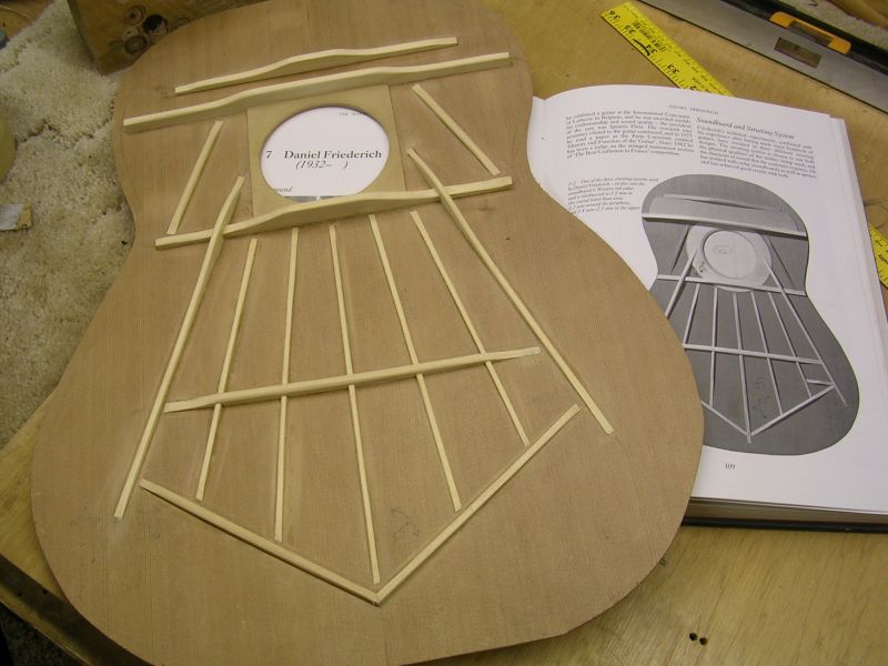

Ronn, nice looking work, mate! Studying the Freiderich picture your top is lying on, I noticed a wee little brace--sitting horizontally--at the top of the lower V.
All I can see is the bass side, so there could be one on the treble side. What do you suppose he's doing with that? To me (and here's a SS sting maker talking), it seems counter-intuitive. I don't get it. Is that explained?

[QUOTE=Steve Kinnaird] Ronn, nice looking work, mate! Studying the Freiderich picture your top is lying on, I noticed a wee little brace--sitting horizontally--at the top of the lower V.
Steve[/QUOTE]
Unfortunately it's not explained. There is one on both sides. I left them out. Look and you can see that I have deviated from the picture in other areas as well. Not for any good reason It's just what I did. Again this is all experimental. If I decide to build with this pattern again I may get a little closer to the picture/plan in the book.
I've been listening to Roberto Aussel and Alvaro Pierri lately. They both play Friederich guitars and the sound is, to my ears, quite different from what I am hearing from other makers. Not exactlly the sound I'm looking for(close), but very pleasant. The trebles are very piano like. I'm quite curious to see what this one sounds like.
